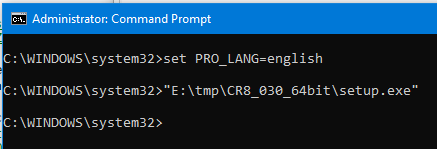

Try something like this

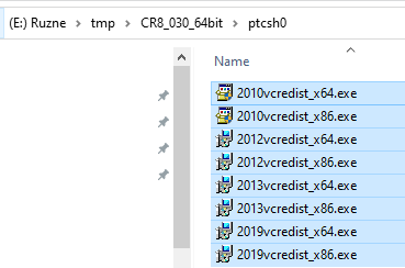

Also you can install MSVCP packages before starting installation

Still produces the same error, both in CMD and Powershell, again both started as administrator 😕
Faulting application name: setup.exe_Creo, version: 36.0.2021.403, time stamp: 0x61a0bcb2
Faulting module name: baselibmt.dll, version: 36.0.2021.403, time stamp: 0x61a08565
Exception code: 0xc0000005
Fault offset: 0x00000000000183da
Faulting process ID: 0xbc4
Faulting application start time: 0x01d8660347168829
Faulting application path: C:\tmp\Creo_8030Win64\setup.exe
Faulting module path: C:\tmp\Creo_8030Win64\pim\x86e_win64\baselibmt.dll
Also, all these MSVCP packages were already installed, I guess due to having several Unity and Visual Studio versions on the machine. I also checked the other executables in this folder, all of them are already installed.
