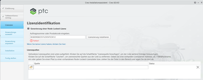

thank you for your help. The setup.exe randomly worked yesterday without changing anything in my settings but now the license identification doesn't work. There ist always an "Error". The license is from my university so it should work. So any ideas about that problem?

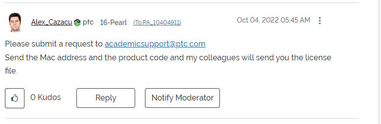

according to https://community.ptc.com/t5/PTC-Education-Forum/Creo-installation-stuck-at-processing/m-p/828065#M13079
you can send request for license file via email. When you receive it you can install Creo using this license file as Source (bottom part of installer window from your picture).
