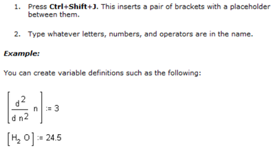

Adding square brackets with CTRL-SHFT-J is not the same as when you add them with CTRL-SHFT-K.
You can test this out by trying to remove only one of the brackets added with with the J method. You will not succeed (both are removed on the deletion of only one). With the K- method you can add, or delete a single bracket, just the [ or the ].
But with the K-method you cannot create the more complicated examples that you can make with the J method. (see my screenshot of the help file further below).

Small mistake. What you describe is [CTRL-SHFT-K], It toggles between normal and 'special' mode that allows you to put symbols like $, . and & in a variale name.
The [CTRL-SHFT-J] immediately puts square brackets around the selected variable, no matter where within the variable the cursor is. I seem to remember it was named 'chemical notation'. Checked: it's 'chemistry notation':
