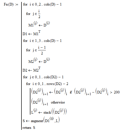

Hello guys, I need help with deconvolution of experimental spectra (~400 of them) that contains two peaks - one is Lorentz and second is Breit-Wigner-Fano shaped. Files are attached. Can this be done in Mathcad? Any help is appreciated. Thanks

If I understand, you want to execute this sheet for 400 different files.  You can do this in Mathcad, but it would be far easier in MatLab.
You can write a program in Mathcad to combine your operations, this would take the raw file and return the array S:
You would need to write a second function to finish the task (or add to this one.)
Then an array of 400 file names, and a program that executes a loop that reads each file, calls the function above, and writes out a file with your results.
Not simple.

Thanks for the help. There is only one file that contains all 400 spectra. In a mathcad file FF is actually a matrix that contains one column of x values and 400 columns representing y values. So matrix FF actually contains all the data of 400 spectra (filtered and selected) that should be deconvoluted.

This quick patch is far from perfect, but it gives you a place to start.

Dear Mr. Kohlhepp, Thank you for your help. The deconvolution of the spectra can be performed better, but I as you already said, this is a very good starting point. Best, Zoran
