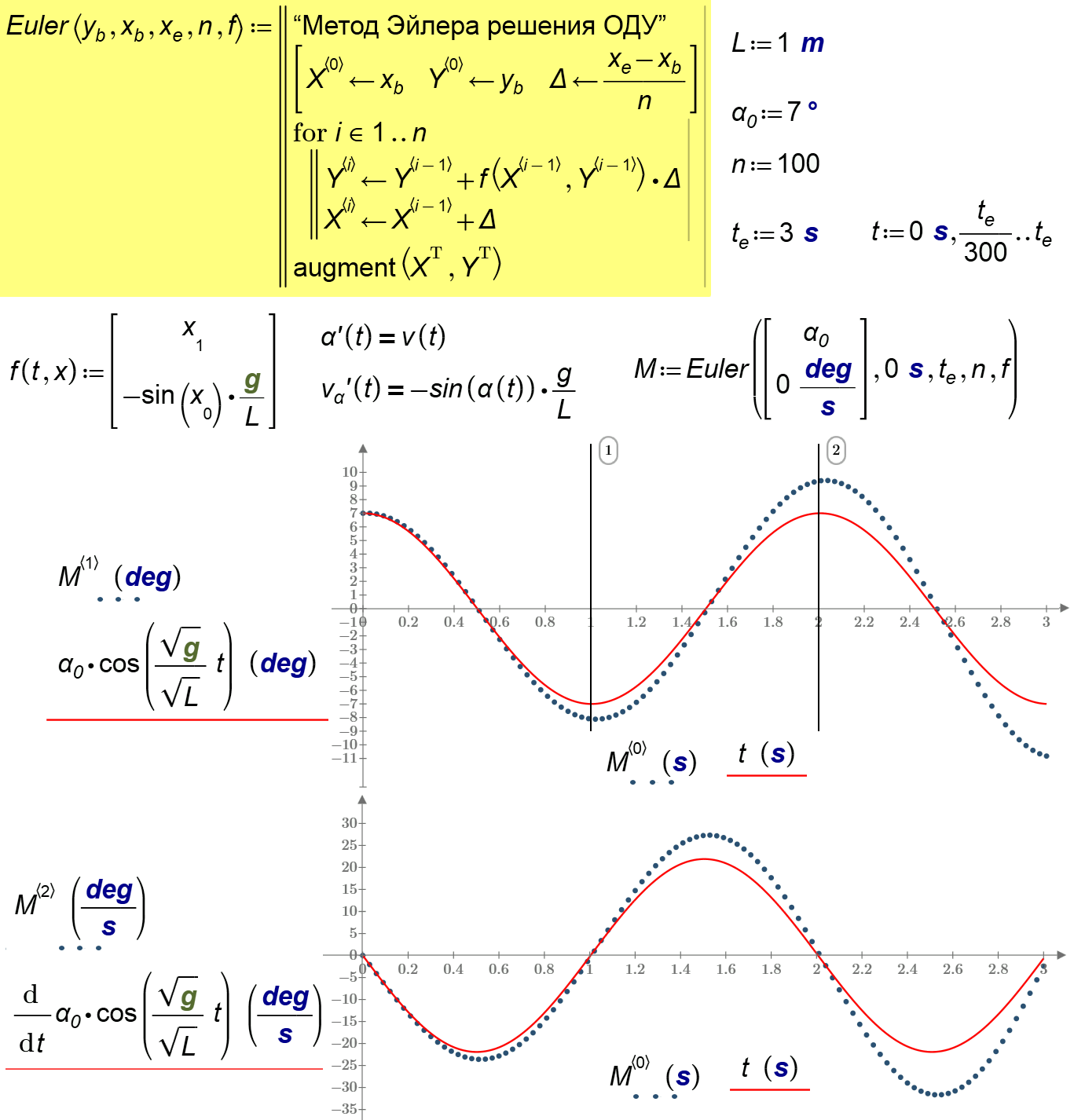

You can down load sheets (MC 15 and Prime 3) of the Euler Method of ODEs solution.
One question - how simple have arguments of the augment function - as in rkfixed (see the plot please)?
Must be one form for this arguments for one ODE and 2, 3, 4... ODES.

But I prefer this variant (for the book)

Привет Валерий ,
The problem with the results is that the nesting is not consistent with the output from the standard rkfixed ODE. Although it might look notationally simpler and more consistent, it presents problems with using the data later on ... the graph notation is quite complex to do what it does. You might be better off using a column operator for the Y data, spicing things up with a mix of column operator for Y and row operator for X, or even using just the column operator to retain the notational consistency.
One other minor observation is that you need to index i from 2..n+1 to get the same number of points as rkfixed.

I think this is a final variant (for one equation and for a system):

I missed this until now, but if you want the last point to be at x.e, then delta should be equal to (x.e-x.b)/(n-1).
and rkadapt
