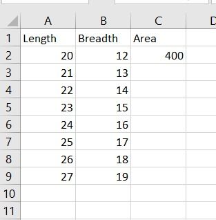

Hello ,
Is it possible to get all the values back to Excel as a product.of L*B as an area. I tried with one row but it is too much time consuming. I believe there is some other way to do may be by programming but I am not sure how to do that can please someone help.
Somehow I was unable to add excel sheet so attaching screenshot

See attached.
First check the contents of Book1.xlsx.
Then open the mcdx file with Prime.
Then re-check the contents of Book1.xlsx.
