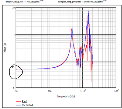

I am back at looking at the equation of the Freq. Resp. Assurance Criteria (FRAC) and would like to know if someone could advise me on what I am doing wrong
I have 2 vectors (realdata & predicteddata) containing complex data. see attached mcad15 sheet
I am trying to calculate the (cumulated!) FRAC bu I think I am getting garbage ! I would expect the cumulated frac plot to stay close to 1 up to 500Hz but it drops close to zero to zero. Might be a "scale" issue for one of the vector
any hints, help, advise would be welcome
Regards

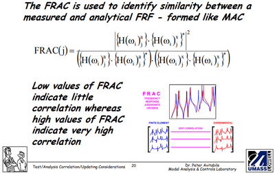

A short search found the following definition:
Reviewing your two responses:
reveals a divergence at the lowest frequency.  (Further divergence, "close to zero at zero," is due to there being no data below 10.)  So the FRAC looks like you expected (mostly!)  Take the win!
Thanks for the hint Fred. Yes that's the equation I am using
I can start the FRAC calc at say f =100 and it makes no difference. I think it because I had  a "picture" in my head. I expected the FRAC curve to start going up (back to 1) near the 1st main peak as real vs. prediction is not bad. In reality it's stay at 1 until the difference (between the 2 vectors) kicks in. I plotted the FRAC, see attached, on top of the real & prediction data and I think it makes more sense. Happy to be corrected on this one.
the FRAC approach is still telling me that the prediction (vector) is a poor match to the real (vector). A visual inspection concludes that it's not that bad (actually quite good !!).
The frequency responses have two parts--magnitude and phase.  Your FRAC (I believe) looks at both.  While your magnitude graph shows good agreement past the first resonance, you haven't looked at the phase correlation.  I suspect that's why your FRAC drops so far so fast.  Plot the phases of the two frequency responses.

I might be one of those helicopter dynamacist ! and I was initially thrilled at the correlation as they're almost the same shape.
I am applying the FRAC formula as found/described in the literature. As it is applicable to FRFs, the vectors are complex (real &imaginary). I do have a plot of the phase. Will play around with the magnitude only

I have that paper - one of the 1st one I used. A aerospace spec is giving the equation show on the attached

I've come to the (belated) conclusion (after looking at your image file,) that what I'm proposing isn't what you want.  You're trying to compare theoretical and measured transfer functions, not spectrums.  We would measure them by applying a shaker or a rap hammer with a force transducer, and one or more accelerometers, then dividing one signal by the other as the frequency swept (for the shaker.)  This is not what I've been trying to do.  Sorry I've wasted your time leading down a wrong path.

You are spot on with the transfer function. the FRAC compare the transfer function (which are complex vector ie at each frequency the value is a complex vector.
For my test I do not divide by the shaker unit (it's a constant) but can do ultimately. if one divide by the input force then one get the inertance (accelerance for some people). I never get a input force, only the input (shaker) acceleration.
