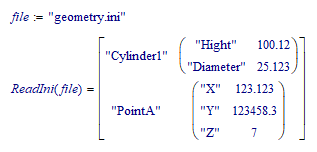

I have configuration files in INI format. I would like to read these in Mahcad. Can someone give me a tip as I can read the values ​​individually one by one in MathCad variables?
Something like a := READ(File,Section,valuename)
1 ACCEPTED SOLUTION
Here is a first approach. Not much error handling included and will work for "well behaved" ini-files and numerical values only.
MC15 worksheet attached

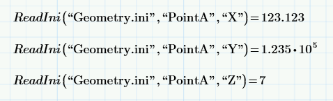

Here's the first incarnation in Prime 4:
Which also works in Prime express.
LucMeekes
(To:LucMeekes)

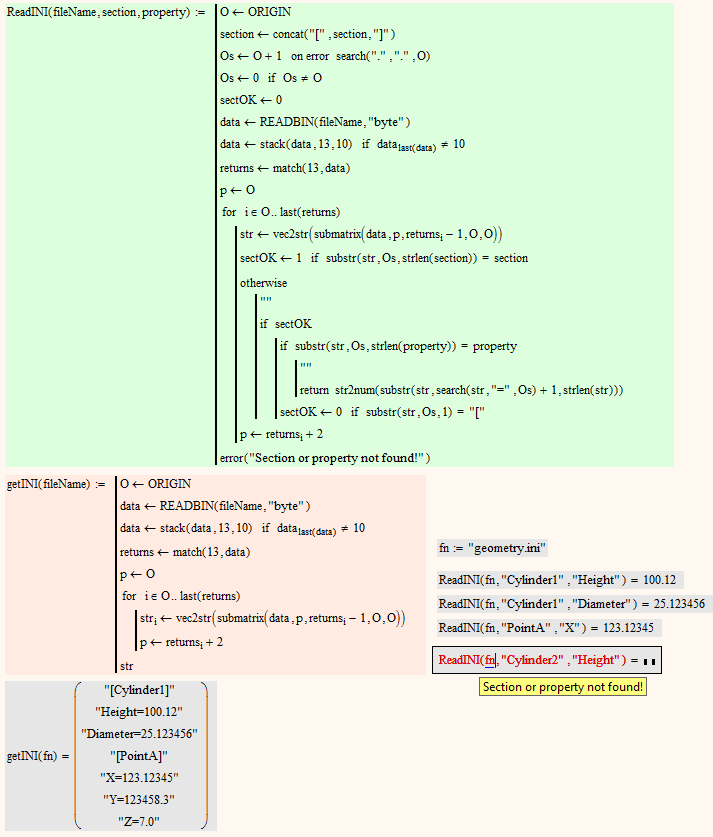

Corrected an error where it would miss the last character of a parameter value.
Since the ReadIni(file, section, parameter) approach doesn't care about comment statements, it's sort of immune to them. This function will even handle this .INI file  https://downloads.avaya.com/elmodocs2/ip_phones/r2_7/output/16_601433_2/IPTel_Server044.html

Example of INI-File:
Filename: 'Geometry.ini'
Content (ASCII-File):
[Cylinder1]
Hight=100.12
Diameter=25.123456
[PointA]
X=123.12345
Y=123458.3
Z=7.0
I would like to read the Value of MathCad Variable CylHight out of the INI-File.
I'm looking for something like:
CylHight:=READINI('Geometry.ini','Cylinder1','Hight')
Best regards

LucMeekes
(To:diedrich)
Note that you test.ini file fails to assign a value to "RT6Kanal" in section [A-Achse]. That will produce a 0 value for that parameter in my update of the function.

Your solutions work as described by you. I have used some of your ideas and have now completed my implementation. The programming is certainly not optimal, but it works.
The INI files to be processed by me are between 500 and 1000 lines long. Therefore, I have disconnected the file read from the search. I first read the file into an array. In doing so, I remove all comments and unnecessary spaces and tabs. When accessing individual values, I use this array.
I attach an example as Zip.

Here's another approach.
In your 'windows' directory you'll find more .INI files. Example:
