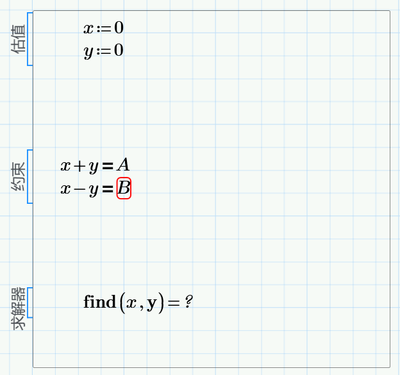

But how about the equation set like this?

The solve block in Prime only works with numeric items, that is, it doesn't work with symbols alone.
If you provide numerical values for A and B, the solve block will give the numeric answers for x and y.

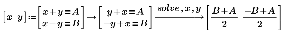

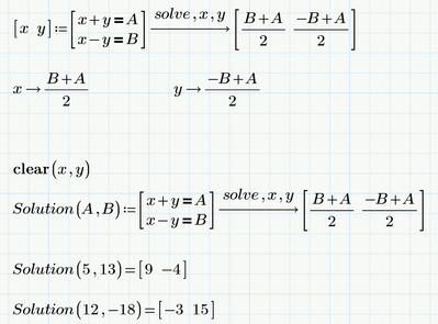

If you want to solve it purely symbolic (with no numeric values for A and B), use the symbolic solver:
You can even assign the results to the variables you solve for:
Note that the expression involving solve turns red. That is because the numeric processor complains that A and B are (numerically) unknown. But the symbolic processor doesn't mind, and symbolically evaluates x and y without problems.

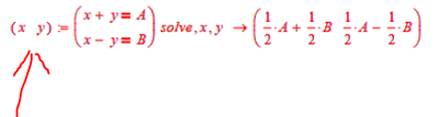

One more question:
How can you input the "(x  y)" ?
Its a matrix (1 row, 2 columns)
Keystrokes:
Ctrl-M (or simply type [)
x
Shift-Space
y
In Prime you get square brackets to indicate a matrix and you also may simply type square brackets to create a matrix.

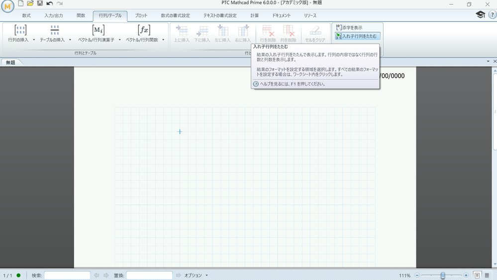

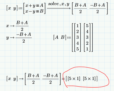

but why i can't get the same result as you? I checked that everything is the same.
ttokoro
20-Turquoise
(To:YZ_9729930)
Just change the on/off of the prime table menu.
YZ_9729930
(To:ttokoro)
it works.
