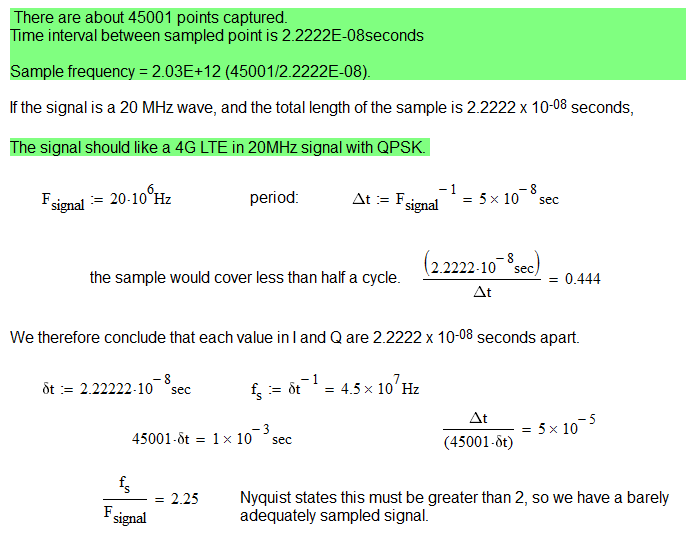

Thank you for the help.  To help my issue, I have attached an Excel containing I/Q points.  There are about 45001 points captured.
Time interval between sampled point is 2.2222E-08seconds
Sample frequency = 2.03E+12 (45001/2.2222E-08).

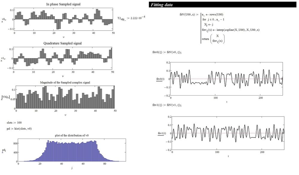

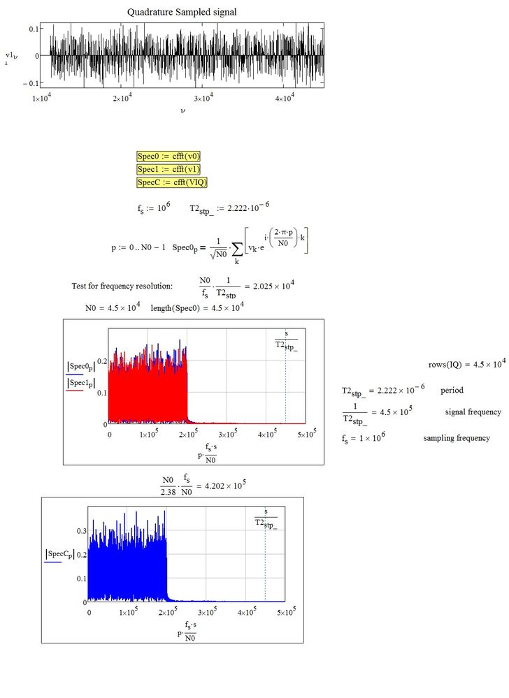

Since the data of the problem are insufficient, the results obtained are the following (see attached worksheet):
Maxplus12
6-Contributor
(To:-MFra-)
I shall look into this. Much appreciated.
The signal should like a 4G LTE in 20MHz signal with QPSK.
There are about 45001 points captured. Can you please what do you mean by insufficient data?
What t's and sample interval was used?
-MFra-
(To:Maxplus12)

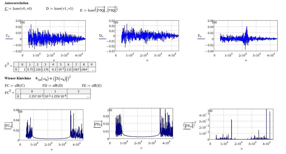

I used the information you gave me, I did not add anything else. The spectrum of the QPSK signal, as you can see from the drawing (zeros) for the low-frequency sample modulating signal, also depends on the digit frequency, which is not known to me. In the first graphs of the signals I and Q, if you reduce the interval, for example from 0 to 50, the graph becomes more significant. You have to consider the two signals as two random processes and apply the relative theorems .

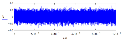

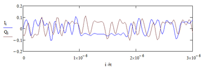

I just started looking at your file for I and Q, the first one that had them together.  They don't look like I'd expect, I expected a fairly constant amplitude, but:
Expanded:
If I superimpose a 20 MHz carrier (note: I and Q rescaled for viewing):
Are you sure about what you have?

I looked briefly at your file, and at your sampling.
Hello
The captured time of IQ data was 1ms with 45001 points ie approx 45MHz sampling freq. The sampling time is 2.222E-08.
The signals bandwidth is 20MHz. As I measured using the signal analyser (IS window), I believe the IF freq is 20MHz.
@Maxplus12 wrote:
Hello
If the entire sample is 2.222E-08, and the carrier frequency is 20 MHz, how many cycles should we see in the sampled data?
If the sampling frequency is 45 MHz and you have 45000 samples, how long should the record be?

okay.  Your calculation of sample time is based on the assumption that the 45001 points span a millisecond.  If that's true then your sample time (my delta t) and sample frequency (fs) agree.
But you say that these two signals are supposed to be very narrow frequencies (20 MHz) that shift phase.  So we should expect the amplitude plot of the FFT of either I or Q should have a vary narrow single spike.  (If we got the sampling frequency wrong the spike won't be at 20 MHz, but there should only be one single frequency.  We all agree that the signals span 20 MHz (a 20 MHz bandwidth).  These are NOT QPSK signals.

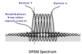

I believe we've been chasing different technology.  I typed "4G LTE QSPK" into Google and found a whole lot of info.  Check out tutorial on LTE data transmission
Quoting the article:
"LTE uses the popular orthogonal frequency division multiplex (OFDM) modulation scheme. It provides the essential spectral efficiency to achieve high data rates but also permits multiple users to share a common channel. OFDM divides a given channel into many narrower subcarriers. The spacing is such that the subcarriers are orthogonal, so they won’t interfere with one another despite the lack of guard bands between them. This comes about by having the subcarrier spacing equal to the reciprocal of symbol time. All subcarriers have a complete number of sine wave cycles that upon demodulation will sum to zero.
In LTE, the channel spacing is 15 kHz. The symbol period therefore is 1/15 kHz = 66.7 µs. The high-speed serial data to be transmitted is divided up into multiple slower streams, and each is used to modulate one of the subcarriers. For example, in a 5-MHz channel, up to 333 subcarriers could be used but the actual number is more like 300. A 20-MHz channel might use 1024 carriers. The modulation on each can be quadrature phase-shift keying (QPSK), 16-phase quadrature amplitude modulation (16QAM), or 64-state quadrature amplitude modulation (64QAM) depending on the speed needs."
I believe that is what I and Q are, each constitutes a combination of carriers which we would need to sort out to be able to demodulate.  The article shows what the FFT of this carrier signal looks like:
Look familiar?
