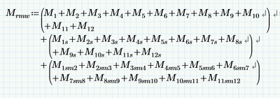

I am still learning Mathcad. I need help with making some of the formulas easier, with looping or any other technique.
My spreadsheet is full of some equations with toms of variables, each one is calculated previously 12 times,
I appreciate it if someone can provide a shorter format for each of the following four equations, and I will try to apply the same technique in all of them...
Thanks a lot

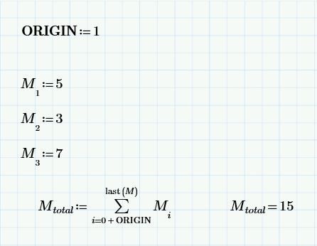

Make sure W and Ws are vectors, then you can use summation:
And be sure to attach your worksheet for further help, not just a picture.

I do not think that this is what I need.I apologize if I was not clear enough.
I already have W1, W2, W3, .... etc defined before. Similarly for all the variables on the right-hand side such as M1sm2, M1sm3, etc,
I want to rewrite the four equations: WcswWssw, Mrmw, and WTw  in a shorter form instead of repeating all the variables, getting an advantage of the looping technique...Thanks again
Example you use M[1 to define the variables.  They then make a vector that can be summed.

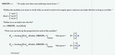

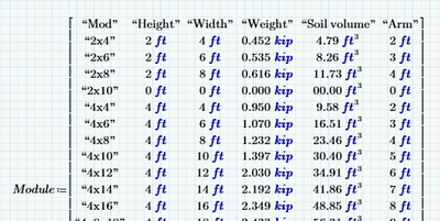

Here's the proposed approach:
See attached Prime6 file.
With this you don't need the variable NM anymore, and also the first row of your Module matrix is obsolete, or you can change it to titles:

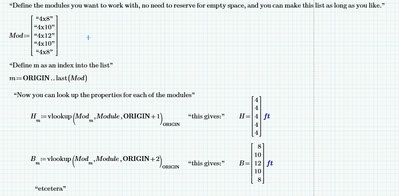

If you want to calculate more than 3 items, just add them to Mod. You don't need to change the other formulae, the definition of m takes care of the number of items. Example:
Next thing is, you need to make sure that all your calculation can deal with the vectors.
Hmm. I see that your further formulae use ORIGIN=0 (the default) . Maybe better keep ORIGIN=0.
Just delete the 'ORIGIN :=1' definition and all is well.
