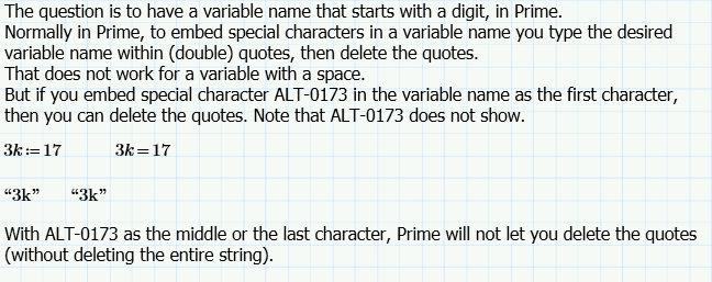

LucMeekes
(To:ppal)
Done
Attached is the Prime 3.1 file.
The same trick works in Prime 4.

@ppal wrote:
Paste results in ?  not 3.
First type quotation marks, then paste the З, then delete the quotation mark.
After that, I'd copy the variable name and paste it where needed in equations.
I also like Luke's solution.  I was unaware of ALT+0173.
LucMeekes
(To:ppal)
Done
