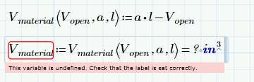

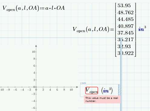

I'm trying to plot the function listed below but it seems to have an issue with the label formating or something. I have a second copy of this file that was modified for other uses but does not have this issue. I checked the 'label' setting of each variable and made them the same as the other sheet but it obviously doesn't work.
When I try to use Vopen in another funtion I get errors as well like...
and...
Although in my other sheet, both yield a 1x8 array of answers...
What am I missing here?

I don't have Prime available right now, but . . .
Try putting the whole expression Vopen(a,l,OA) in place of just Vopen in the graph.
