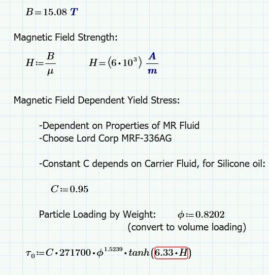

Desperately need help trying to figure why this unit is giving me problems. Calculating Shear stress in a smart fluid subjected to a Magnetic Field from a solenoid. C and phi are unit-less I believe.

The argument to any of the trigonometric functions must be dimensionless. That's also true for the hyperbolic functions...
I guess this expression for tau0 is empirical.
