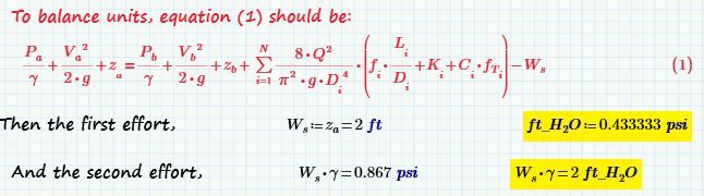

Okay, attached (in Prime 4 Express) is a start through the paper Piping-System Solutions Using Mathcad, B.K, Hodge and Robert P. Taylor, May 1, 2002.
By doing a unit balance of equation (1), we can correct the equation and demonstrate that the conversion factor is NOT required.

I spent (roughly) twenty years doing this type of calculation (and others) in Mathcad and wrestling with units.  Much of that effort was spent taking expressions like equation (1) and making sure the units balanced properly; That's what I was attempting here.  "all unit conversions are essentially multiplication by 1. They are never necessary but always helpful."  One of Mathcad's features that has saved me numerous times is the automatic unit conversions.  If I expect an calculation to result in a moment (ft lbf) and the answer Mathcad labels J, I can simply replace Mathcad's units with mine:
Capture.JPG and have the units I want.  If I screw up the input, Mathcad balances the units Capture1.JPG, and I can see there's a problem.
