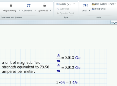

So you are technically correct, Oersted is not SI.  Prime 4.0 Express with CGS unit specified.  (Built-in unit not specified?:
With MKS specified
And with USCS specified:
So Prime has issues with units.
