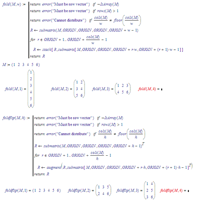

Matrix-1x6 To Matrix-2x3 ?
lvl107
20-Turquoise
Hello Everyone.
Thanks in advance for your time and help.
Regards.
1 ACCEPTED SOLUTION
LucMeekes
(To:lvl107)
I guess foldflip is your function.
2 REPLIES 2
LucMeekes
(To:lvl107)
lvl107
20-Turquoise
(To:LucMeekes)
I'm very happy got your help, Luc.
Best Regards.
