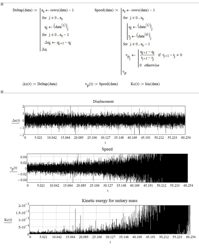

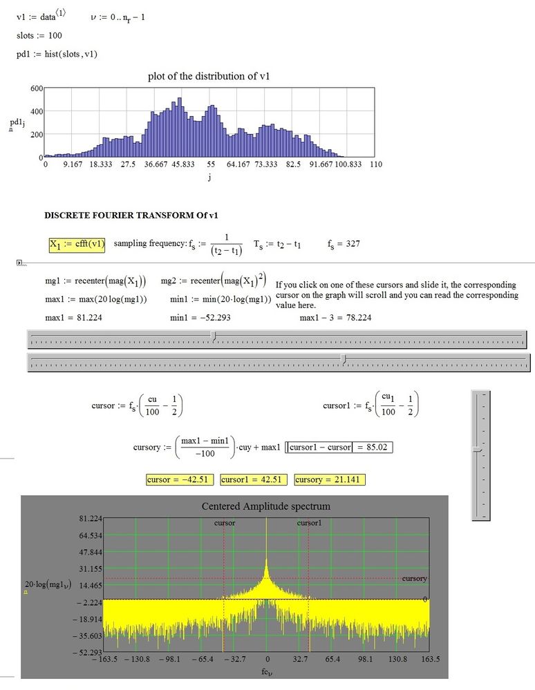

I have a data that contains the position of a particle as a function of time. When I apply the fourier transform I do not get any frequencies however through the time position graph and the position histogram, I can see that the particle has a position around which it oscillates. I also need to calculate the power spectral density (PSD) as a function of frequency. Has anyone ever worked with something like that?
The original data is attached.
Thnak you.

Something like this...?
Unless I have forgotten, the first term in a CFFT is the steady value (equals the mean.)  The first frequency should then be zero,  And the magnitude (except for the first term) should be doubled.
LucMeekes
(To:Fred_Kohlhepp)
I took off the first element, kept the remainder of the first half of the spectrum data and doubled that.

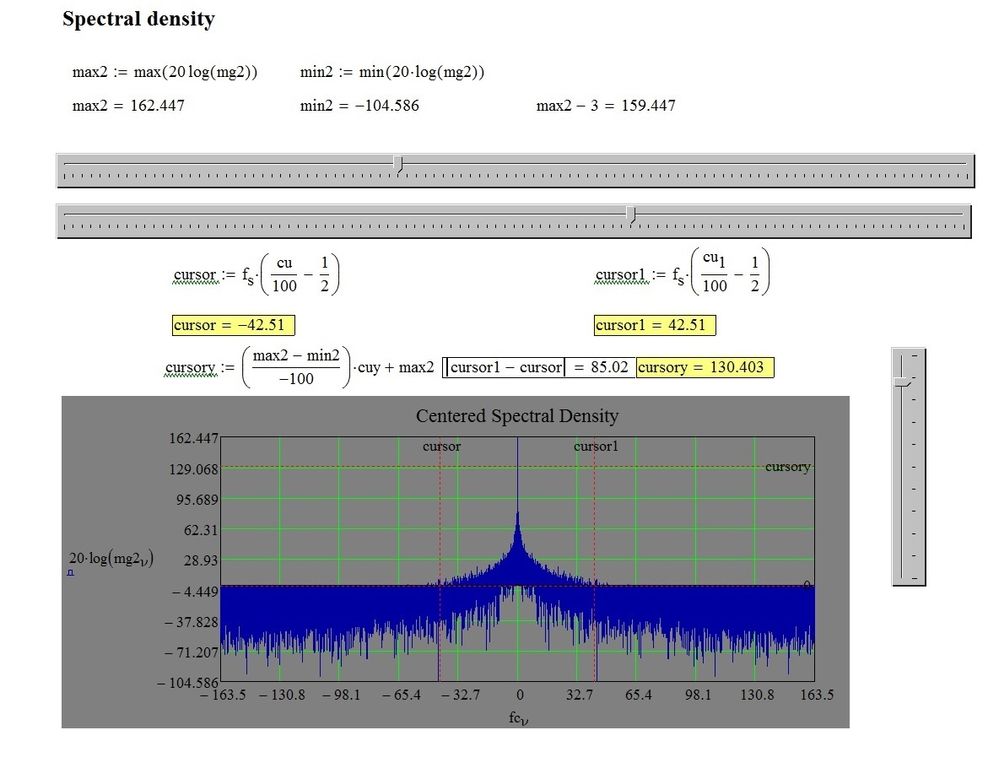

The particle does move back and forth about its average value (~82). However, it does so essentially randomly, with no single discernible frequency. Luc has done the essential calculation. However, there is a scale factor that needs to be applied in order to get the correct quantitative values for the power spectral density (PSD). For the signal p(t) with N samples, let P = CFFT(p). Sp1, the single sided PSD is defined for f=0 to fNyquist, and is given by
The factor of 2 sums the power for both positive and negative frequency components for f>0. Since all of the DFT routines, including CFFT, deal just with the data vectors, there is no information about the horizontal scale, be it time, distance, or something else. The N/fs factor provides the correct scaling (with CFFT) so that the result can be interpreted as a power spectral density. If the units of the data p are mm, then the PSD will have units of mm^2/Hz.
The plot shows my calc of PSD, a smoothed version, and a reference line of 1/f^2. The PSD follows the 1/f^2 behavior quite closely over the full frequency range. MCD v11 file and pdf attached.
