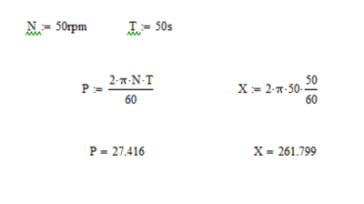

Please help me to check where i am doing wrong.
LucMeekes
(To:ICAD_Support)
That depends on what you think is 'wrong'. What did you expect as value for P or X?
You're using units rpm and s. Do you know what they mean?
In your formula for calculating P (or X) you use a division by 60 and a multplication with 2pi. What is that for?
Have you checked the ratio of X/P?
As per the answer of X & P..
Values in P : N=50rpm & T= 50 sec
Answer should be : (2 * pi * N * T)/60=261.8333
but it getting : 27...
If i put the numbers instead of defined parameters, answer is right.
then why the answers of X and P are not matching..?
Looks like you did not understand the unit rpm (revolutions per minute). The factor 2 pi /60 is already part of it.
So get rid of that factor and simply calculate N*T
For future questions open a new thread and keep in mind to always also attach your worksheet(s).

You did not answer all questions that I formulated. This means that you do not understand yet the usage of units...
Do you know what '50 rpm' means? Note that it is VERY different from '50'.
Why does your fomula for the calculation of P use a 2pi multiplication and a division by 60?
(I see that in the mean time Werner explained the situation. I was trying to get you intrigued into finding out yourself what is going on.)
