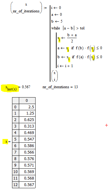

Simply return a vector with both value of interest:
Thank you very much! It worked for both versions, Mathcad 15 and Mathcad Prime too.

To return the history you'd like to see you could store all x-values in a vector and return that vector instead of the last calculated value.

I found a strange difference between Mathcad 15 and Prime: Mathcad 15 solved the equation with 13 iterations while Mathcad Prime solved the equation with 19 iterations.
Nothing strange - you get the same number of iterations if you use the same tolerance value for "tol".
You have different values in your two sheets.
BTW, as you now return the vector of x-values you can get rid of returning the value of i - you can determine the number of iterations by counting the number of values in the result vector:
Yes, indeed... Too many zeroes.
