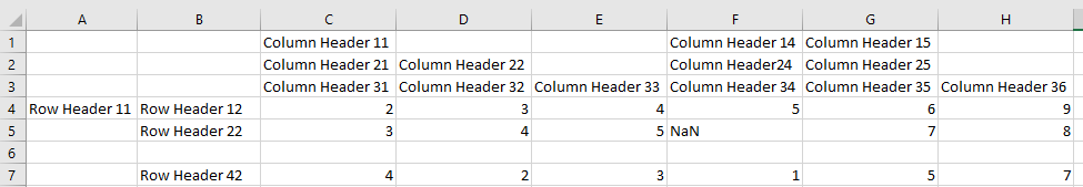

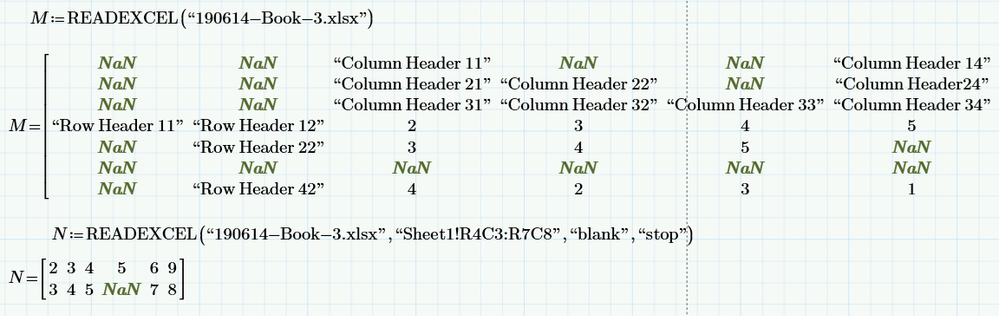

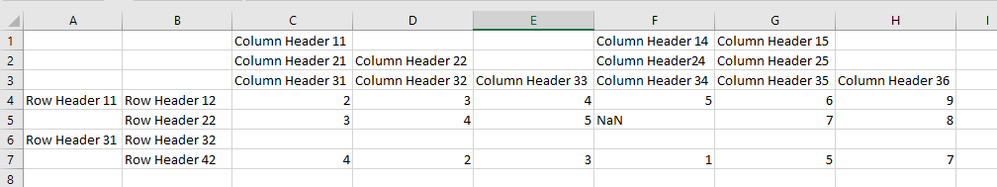

Here is a sample excel imported into Mathcad.  It shows what happens with Nan's and "stop"  You can easily see using this sample file what READEXCEL does.
If the entire row is blank including row headers "stop" works as an option in READEXCEL
Cheers
Terry,
It looks like your solution is substituting the string "stop" as emptyfill, and I see the program doing that; filling the empty cells with a string.
For my program, I would like to specify a fairly unbound end row. My current code shows 500k but even better would be 10M. I want the data import to auto stop at the first empty row, and not actually run out to the range I specified.
The ability to "stop" on an empty row seems to work with this small sample file. N is only two rows.

The syntax you use is correct and should work (and indeed does so in a small example file I created)
basically Terrys lat post shows that, too. You may replace the string "blank" in his example by NaN.
So if it does not work with your Excel sheet, it might be that the row you think is empty in reality contains some hidden data and so is not seen as empty by Mathcad.
You should create a smaller sample Excel file and post it here along with your Prime worksheet.
