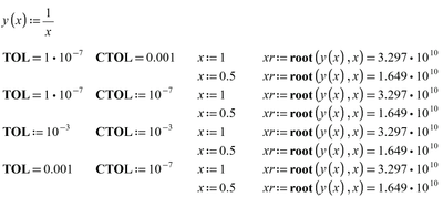

In Mathcad 11? But in Mathcad 15 and Prime. Send please your Mathcad 11 sheet!

Worksheet is attached to my first answer.

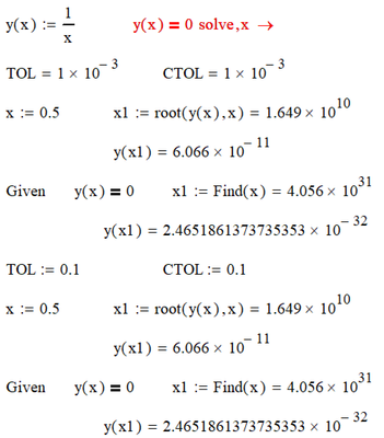

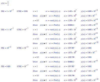

What does it give in Mathcad 15?

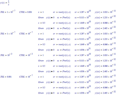

prime
LucMeekes
(To:ValeryOchkov)
Looks like they broke something between between Mathcad 11 and 15...
Variables TOL and CTOL affect the operation of functions Find, (Minimize, Maximize ?) only when changing the calculation method. But we cannot do it in Prime!
