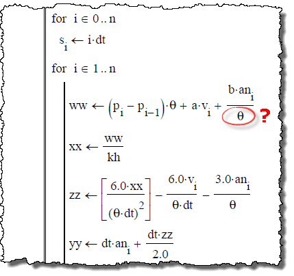

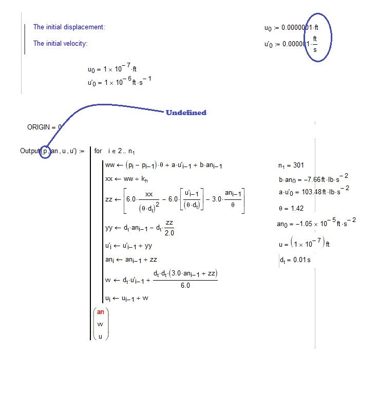

as you see from the following picture, the variable p is undefined. Furthermore are missing some unit of measure.
Regards

Good Afternoon FM,
Please see a modified copy of the file you are helping on translation of Matlab file into Mathcad file. I have shown the p vector and changed the units as suggested by you. My Output is still not producing any result. Would be kind to see what I'm doing wrong.

The equations are not unit consistent.
So you have to enter values in the right units without declaring units in mathcad. Only enter the values.

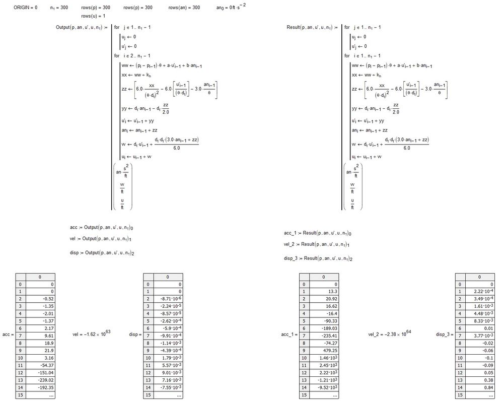

I guess your indices are inconsistent. You write u[i where in the Matlab file there is u(i-1) but you already corrected the different ORIGIN by looping from 1 to n and not from 2 to n1. You shouldn't "correct" it a second time.
Unfortunately this results in incredible high values. ??

Hmmm, what did you change? (I'm too lazy to compare)

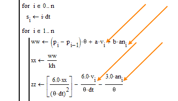

These were some of the indices I was talking about
They should all be i-1 as in the Matlab file. v[i for example is always 0 at the stage (in the Matlab file it even would not exist as vector v is not prefilled with zeros as you did).
The indices should be the very same as in the Matlab file as the ORIGIN shift from 1 to 0 is already considered by the limits of the for-loop.
When i=1 in your program we have to use v[0 as v[1 is not even defined yet (its 0 because you prallocated the whole vector)

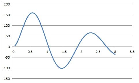

This is the answer for deflection in some structural software I use.
Good Morning Terry,
Thanks for your help. The structural analysis package plot is the correct answer. Also my plot in Matlab confirm your structural package. I just do not know what I'm missing in the programming in Mathcad, that is not making the plot right. I tried to modify your Wilson file with units with no luck, see attached.

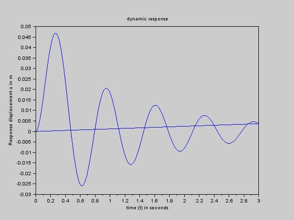

I do not have a copy of matlab but use the freely available SciLab.  It is easy to translate Matlab to Scilab.
In this instance just change the % comments to //.  I get this in Scilab.  Give me some time and I willl get this in MathCad.

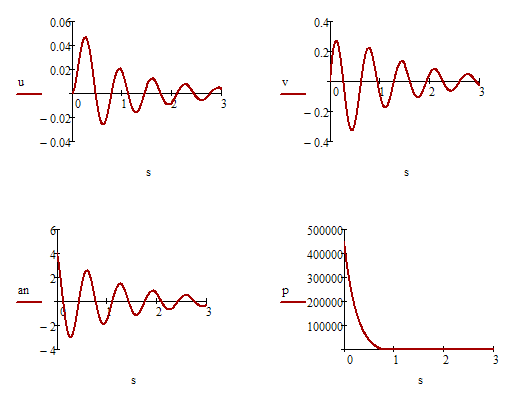

Good Evening Mathcad Community,
I would like to thank you all for your help. Terry, FM, Werner and the rest of the community. I want to convert the Matlab file into Mathcad because of the units in Mathcad. The file plot exactly as is shown on your page Terry. Thank all.

Checking through this carefully.  I know at least zz is calculated incorrectly in the MathCad sheet. Carefully following the brackets in the matlab file still doesn't fix the problem.
I do not have matlab but use scilab.  Nearly the same thing and free.  It gets a good plot but is still not the correct answer because of unit errors in the matlab and scilab files..
Oh yes, you are right! That was pretty tricky with the brackets 😉
Now Mathcad delivers at least the correct results (unitless as in Matlab).
This is correct the static deflection derived by 450000/k is 0.045 m so the  graph of u looks correct
Yes. I just corrected the wrong formula for zz you pointed me to.
Guess I would't have found that error in a year 😉
Now its time for nicer varaible names, units and ORIGIN=0 and maybe turning the whole calculation into one function.
