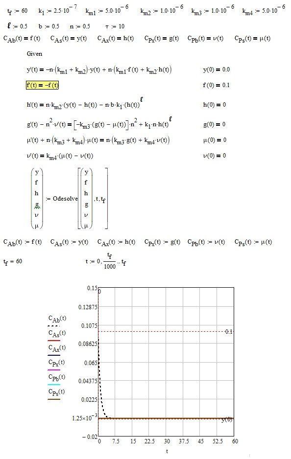

-MFra-
(To:JPark61)
If I knew, for example  the diff. eq, f' (t)=f(t), there would be no problems, see image:
