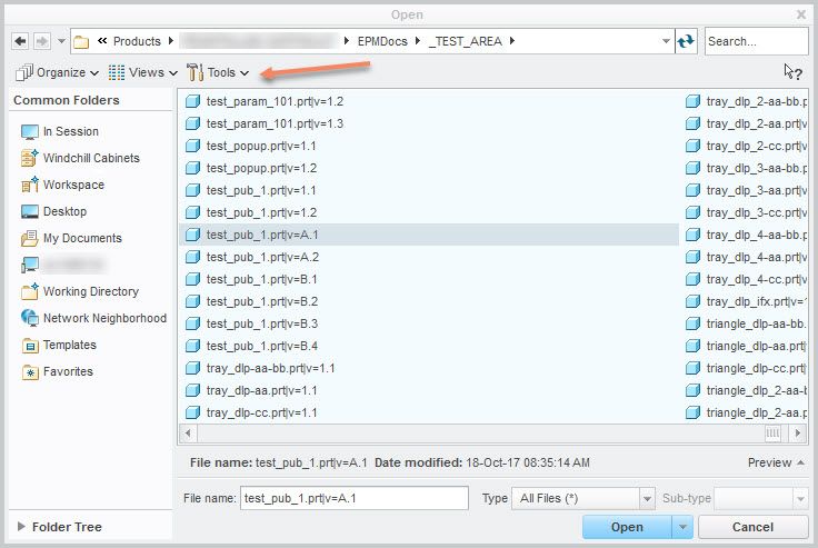

Navigate in Windchill Cabinet to the location of the version of the file you want to compare. Select Tools drop down list and then All Versions. Select the desired version and the Open.
Super simple to do.
