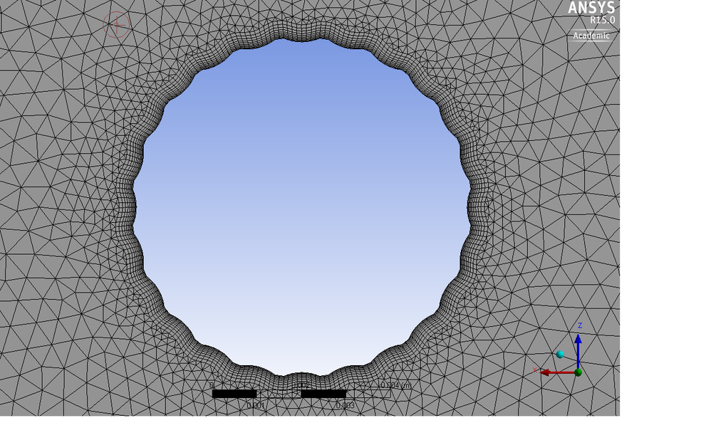

Hello, i wanna cut the shape of  a golf ball out of a plane shown in the picture in Creo Parametric. Any guide/tutorial on how to do that?
1 REPLY 1
Hi, in the Creo create a datum plane like you need.
Select created plane and use SOLIDIFY feature (as romeve function) - try to check similar example here:
