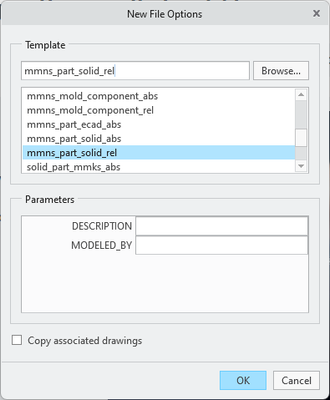

3. For Get Started with Creo Parametric Modeling and Get Started with Creo Parametric Assembly, the tutorials walk you through creation of your own models on your own system. There are no models to download. You start from scratch and create the models yourself. The start parts and start assemblies used for these playlists are the ones that are installed as part of your Creo installation. If you clear the Use default template check box you should be able to choose these out of the New File Options dialog box:

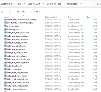

If these templates don't display in this dialog then your admin may have removed them. By default these templates are all loaded in the <Creo Parametric Loadpoint>\Common Files\templates folder:
