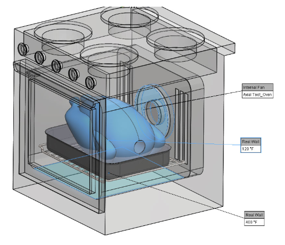

Figure 2 shows the boundary conditions for cooking the turkey. The turkey model was run as a snapshot in time, meaning I set the turkey temperature to some not-quite-fully-cooked yet temperature (120°F). The oven temperature was set to 375°F, with the heating elements being slightly hotter at 400°F at the bottom of the oven.

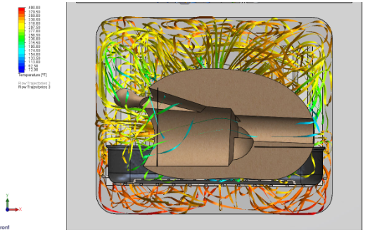

Once I had a good turkey model in the oven (Figure 3), the model was solved in FloEFD and I looked at some streamlines (Figure 4).  Streamlines are similar to smoke streams shown in car commercials when the car is in a wind tunnel. The streamlines show where the air is going. I set the fan as the starting point of these streamlines. Although the streamlines are quite chaotic, there is still information that can be obtained for the analysis.
By sectioning the model, I could see into the roaster and into the cavity of the turkey. Compared to the streamlines outside the turkey, not a lot of air is going into the roaster and under the turkey, and even less is going through the turkey (Figure 5). But this is what I expected, especially for the cavity airflow. The fan is pushing the air across the width of the turkey, not along the length of the bird. The air would have to flow around the turkey and then make a 180 degree turn to flow into the cavity, and there is no reason for it to do so. Because turkeys are so big, they can’t be oriented in the direction of the airflow from the fan.

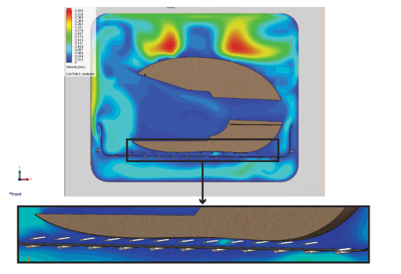

Looking at a contour plot of velocity (Figure 6), going through the middle of the turkey and oven, the airspeed through the turkey and under the turkey is very low, while the airspeed above the turkey and under the roasting pan is more significant. What constitutes very slow air? Well if we didn’t pay for a fan and had a natural convection oven, the typical airspeed for would be about 0.2 m/s. So the fan isn’t providing any improved heat transfer because the majority of the surface area of the turkey is experiencing airspeed less than 0.2 m/s.

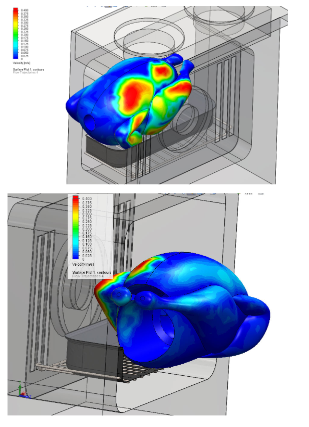

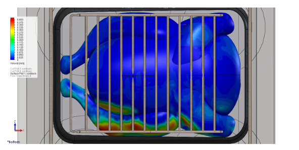

A surface plot of the velocity near the surface of the turkey illustrates the airspeed (Figures 7, 8, and 9). I split this into three images: one shows at the turkey surface close to the fan, another image shows the opposite side, and the last shows underneath. There is a clear difference between the fan side and the opposite side, and the result is that one side of the turkey will cook much faster than the other (or dry out faster), if the turkey isn’t rotated periodically. Faster air equals faster convection, which is why we blow on soup to cool it quicker. Underneath, it’s the same as was illustrated before, that the air is not moving underneath the turkey.
