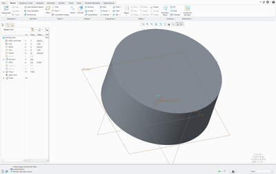

So I'm brand new to Creo and am having a hard time with some basic functions.
It seems like every time I create a sketch, it displays in green when the sketch is selected but then is hidden when not selected. Is that normal?
I'm following a youtube video on how to wrap a sketch onto a curved surface and after I wrap the sketch, the sketch is hidden. That part i get, since its consumed by the wrap feature. The problem is, now the wrap feature is only visible when selected. So when I go to project the wrapped curves, the curves are not visible.
A solution would be great, but also if someone can point me to and explanation of how working with sketches in creo should be approached, that would help me understand what is going on.

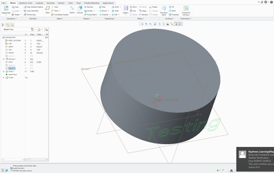

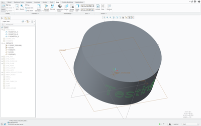

I got your response, thank you. I followed your directions and it didn't quite fix the problems. See the below snapshots and the attached model.
Rob
Nothing on the tree selected
Sketch selected
Wrap selected
Layers - hidden objects
In your original post you should specify what version and datecode of Creo you're on. It may be a layers issue, or it may be "hidden" in the model tree. If it's hidden, unhide it, and save the status....otherwise it goes back to hidden when you close it.
As frank says, they're obviously hidden (you can see that because they're greyed out in the model tree). There can be two reasons why they're hidden:
Looking at your layer tree, I see that there's a layer called DTM_CURVE and one called DTM_CURVE_SK (I think). I'm guessing these are "smart layers" that automatically collect curves, so whenever you create a sketch, one of these layers will automatically collect it. If this layer is hidden (which it looks like it is by default), then the sketch will not be visible.
Right-click on the layer and select "unhide" or "show" or the eye icon (depends on which version you're running). That should display the sketches and allow you to work with them. However, this status is not saved with the model, even if you save the model. Next time you open it, the layer will be hidden again. If you want to always show the sketch, you need to unhide the layer, then right-click in the layer tree and select "save status". Then save the model. This will set your layer tree's "default status", which it will return to every time you open the model.
The reason it works like this is because how the template file (also called a "start part") is set up. The template file has these layers, meaning any new part which is created will have them. This is used by companies to standardize their parts. If you want a different default behavior, you'd have to change the template file or use a different one.
Hope that helps.
There is another config option you could look at, Autohide_external_sketch. I think the default setting is yes, i have this set to no. This option could be responsible for sketches 1, 2 & 3 being hidden at least. They are external sketches to other features.
