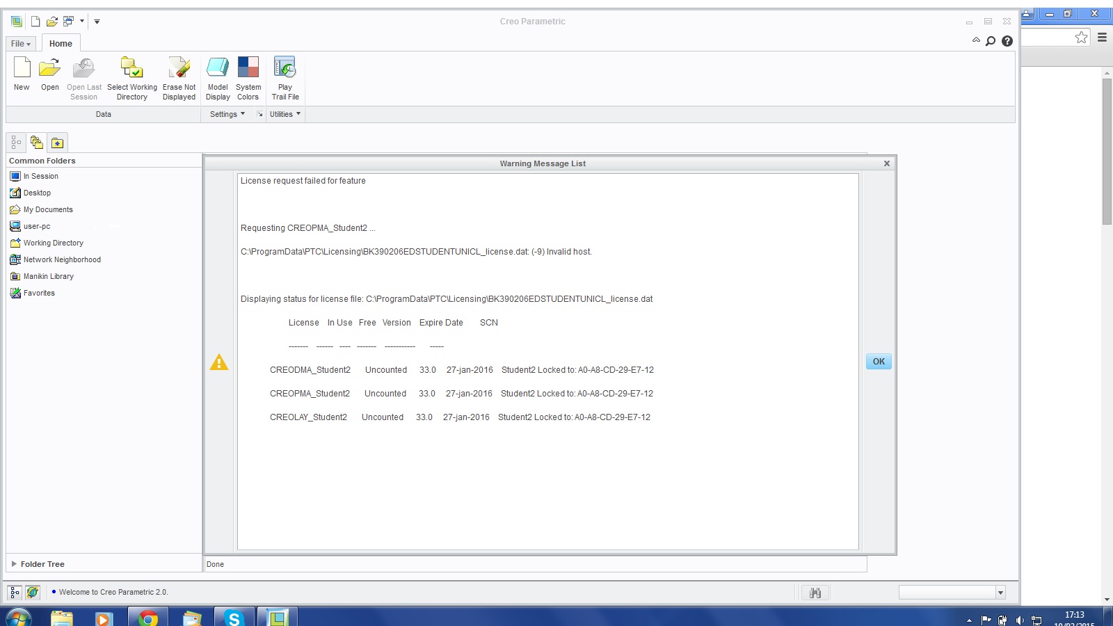

hi,
this message comes up so i cant use creo.
not really sure what to do
thanks
Solved! Go to Solution.
i have fixed the problem by enabling my wifi, but i cannot use it when wifi is disabled
Ben,
your license file (the path to the file is mentioned on your picture) contains a code related to network card MAC address A0-A8-CD-29-E7-12. It looks like Creo cannot locate such network card.
Open Command prompt window and enter ipconfig /all command. Then check the command output - try to find Physical Address A0-A8-CD-29-E7-12. The output can contain more than one Physical Address. Show me all of them.
Martin Hanak
i cannot find A0-A8-CD-29-E7-12, there were 4 physical addresses; ethernet adaptor EC-F4-BB-36-D8-63, tunnel adaptor 00-00-00-00-00-00-00-E0 and two more the same. could it be because i am using cable instead of wifi?
thanks
ben
Ben,
I think you run into Windows Disable Media Sense feature. By default Windows turns unused network cards off. To disable this default behaviour, you can use the following procedure (I use it in Windows 7).
To disable Media Sense, please perform the following steps:

Thanks Martin,
The phycal addresses are still the same
Ben,
can you enter ipconfig /all > ip.txt and publish the contents of ip.txt in this thread ?
if you have two network cards (LAN and wifi) then ipconfig output must contain two different MAC addresses.
Martin Hanak
You have won !
thanks very much for your help and good response
