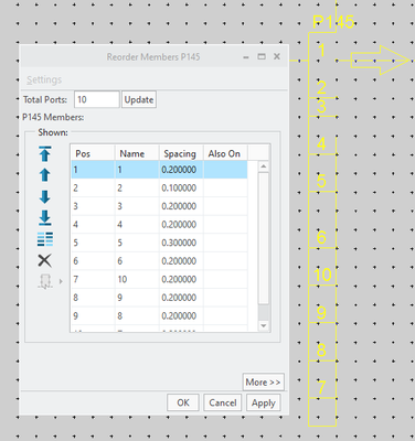

Those of us answering have been forgetting to mention that many of the tutorial videos were made with Version 3 but that should not affect this. I have used the term "previous product manager" a few times. He retired about the time Covid hit and PTC didn't get a new product manager on board until recently. He has a long history with the Schematics team but is just getting his feet on the ground with regards to having the whole picture. The newer versions were primarily problem fixes and people are hoping for some bigger changes in the next version.
When you place a variable connector you should see (we are using Schematics 4, no major changes in the newer ones yet) something like:
[cid:image001.png@01D753A4.838DCFD0]
The bottom icon on the group at the right is place.
[cid:image002.png@01D753A4.838DCFD0]
You must use the Total Ports box at the top and click on update or it does not accept the change.
The placement image will not change until you also click on apply. You can place connectors at any time with the present settings.
[cid:image003.png@01D753A6.7E3862A0]
The spacing is between the item selected and the one under it on the list.
You can change individual spacing, order, or hide items. The More>> button shows you hidden items.
The arrow by the connector, shows the direction of the ports.
If you right click on the connector that you have placed, you can select copy then Paste Shapes to make a copy of the connector with the same ID. If you just use paste, it creates a new connector with a different ID.
The copies with the same ID are the same connector. You can hide terminals in each copy. If you leave two of the same terminal in place, the Also On column will warn you that you have two copies.

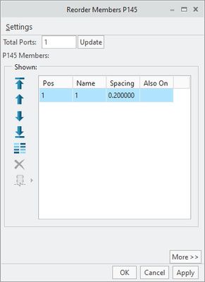

Thus is the problem, if you can see my attached image here,
I don't have the option for "total ports", it just isn't here,
I assume I have the full version of creo schematics, I hadn't heard of a light version.
thanks tho.

I missed your image and see that mine did not show up. I will try to attach them.
Duh! I should have known you have the full version. You talked about the cost. Light version is free but only good enough to do some simple testing.
I should have asked which version of Schematics you have. (should be able to be found in File -> Help -> About...)

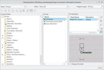

Your Reorder Members window is very different from mine. Hopefully you can see this image.
Does your connector groupshape look something like this, with the dashed lines in the Groupshape?
The dashed lines are part of a variable component. They have to be very specifically created or they don't work. For some reason the middle part is inverted. That connector has the port number ABOVE the port when it is placed.

Thank you, I appreciate the offer,
in the past few days I have found the magic click button
to add ports to a symbol, it's well hidden and didn't look like any one else's window.
obviously everything in creo schematics has to be set up before hand,
this is very time consuming and confusing.
