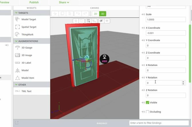

When we try to rotate a model or 3d model item about an axis it seldom rotates about the correct axis as we want.
So in this case we can help with some mathematical calculation. For example having a door assembly:
and when we  try to rotate the door model about 60degree it rotates undesired on the wrong axis.
So the first question is which is this axis and how to change it.

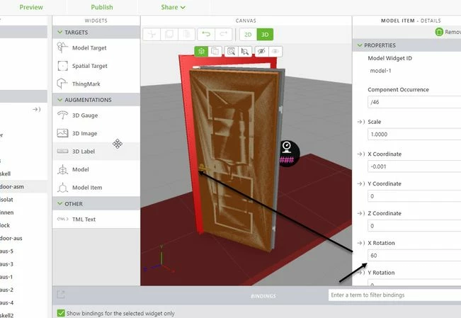

We can use some mathematical relation to get the correct appearance . In this case the correct javaScript relation should be :
$scope.simple_door_slider_change = function (angle, door_length) {
 var angle1=angle;
 var l_door=door_length;
 var angle1_rad=angle1*Math.PI/180.0;
$scope.view.wdg['modelItem-door-asm']['rx'] = angle1 ;
$scope.view.wdg['modelItem-door-asm']['y']  = 0.0 - l_door*Math.sin(angle1_rad);
$scope.view.wdg['modelItem-door-asm']['z']  = 0.0 - l_door*(1.0-Math.cos(angle1_rad));
$scope.app.params['door_angle']=  angle1;
So  calling $scope.simple_door_slider_change(70,0.950); will rotate  this particular door assembly on the correct place:

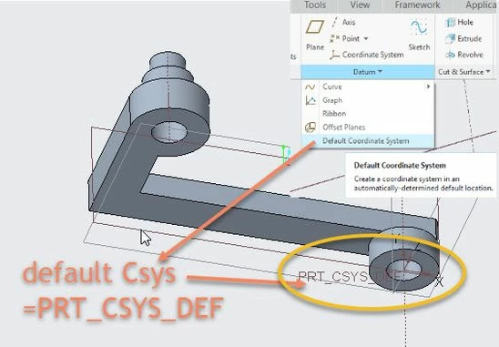

Unfortunately, the only option, what we have is to make some consideration already in the Creo Parametric design. So for example the following part have a default coordinate system. Here on the example picture is the name  PRT_CSYS_DEF.
When we later rotate about the x  in Vuforia Studio  then it will rotate about the X axis of the default csys here “PRT_CSYS_DEF”
So this means when we have some component which should be later rotated in Vuforia we have to consider it in the design and  need to have the default csys on the correct location.
It is not possible to change it later (there is a workaround where we can use an assembly where we can insert the model. In this case we can move the model inside  the assembly. The assembly will rotate about the default coordinate axis of the assembly

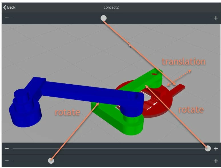

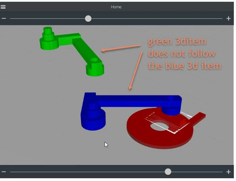

Lets consider the following assembly:2018-06-05_16-14-35.jpg

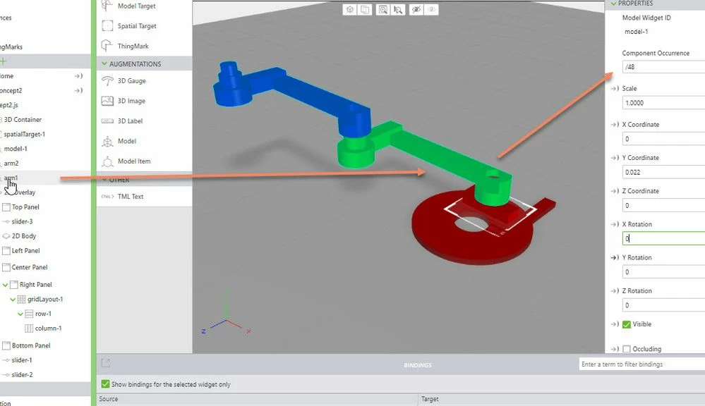

When we create a project and then try to rotate  different components (arms) via slider then we will have
So that the one component is rotated as desired but when we rotate the blue component it does not follow  the green component.

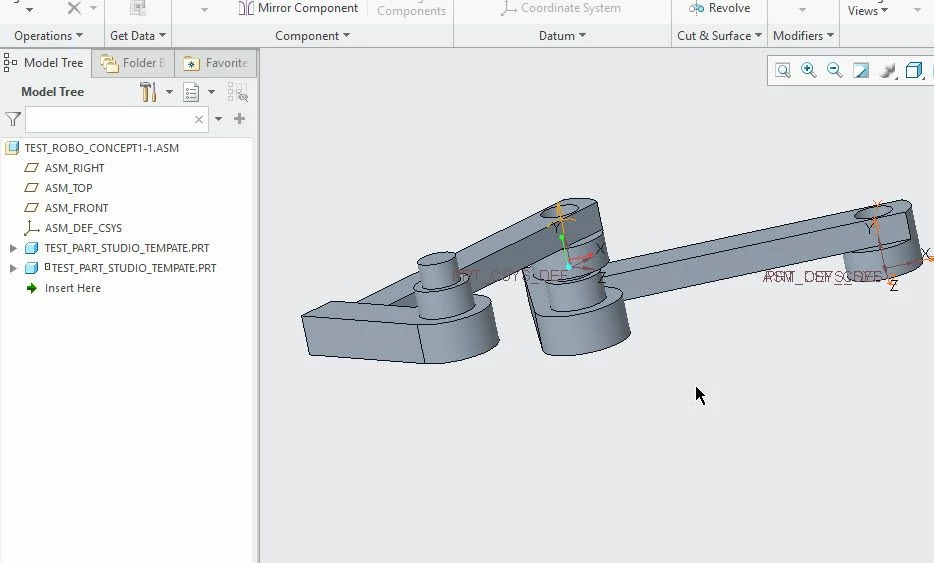

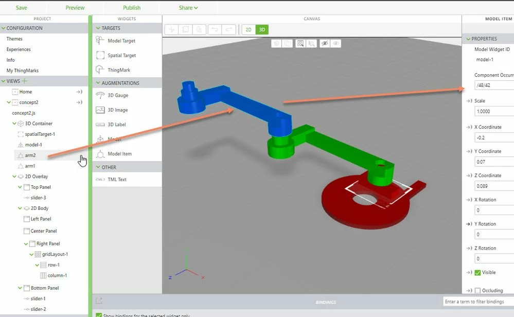

The next version of the mechanism we have the correct behavior:
What is there different?
The answer is that we used a different structure. So we nested the moved component in further assemblies.
It important that in this case the modelItem in vuforia studio we are not using only a parts  but also  assemblies and subassemblies for the definition of modelitems.
So in this case we could change the rotation value of the axis and they rotates as desired.  Man Happy
