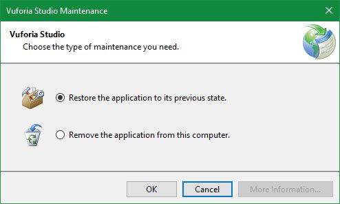

@tmccombie is there an official way to roll back to an older build of Studio? I'm on deadline to get an experience done by Thursday and this is going to slow me down if I can't trust/use the Preview.
@jmikesell Are you on a Windows machine? If so, to restore Studio to the last version you had installed do the following:
  1. Exit Studio
  2. Go to Control Panel -> Programs
  3. Select Vuforia Studio -> Uninstall/Change
  4. Select "Restore Application to its previous state"
  5. Start Studio
jmikesell
(To:tmccombie)
I am on Windows and that worked perfectly to take me back to 8.4.2. Which does not exhibit the problem with click action on ModelItems in a sequence. AKA works as expected
