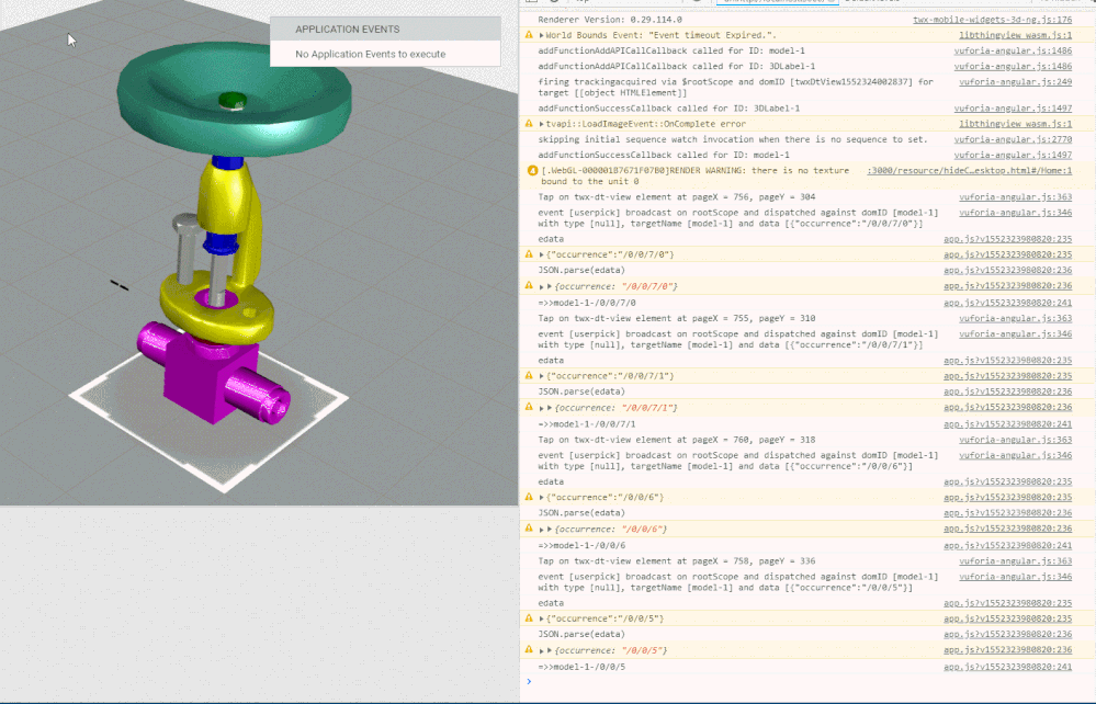

I was trying to figure out an automated way to make punch of parts assembly of my model to be transparent. My model consist of 150 parts and it makes no sense to drag and drop modelitem widget for every part.
I used the following code
      modelitem="model-1-/0/"+i;
      tml3dRenderer.GetObject(modelitem).GetWidget().ApplyOccludeOpacity(0,0);
Everything works good in preview mode, but surprisingly it doesn't work at all in HoloLens. Waste much my time on preview while not all function are supported.
Any help of alternative way to make this work this out?

Hi @nqwifly,
when I am looking on this description , I believe the main intent there is to try ot hide some component dynamically.
Yes I could confirm that this does not work on HoloLens but work on preview.
So this is because there are some differences in the implementation on the HoloLens so that the code will lead to exception.
But actually, the code on the HoloLens is more easily to implement because the display follow the rgba alpha channel parameter and we do not need to set explicitly the opacity (it also will not work) but we need to do this in preview mode.
So the following code:
var PICK_COLOR_OPACITY1  = "rgba(,,,0.0)";
$rootScope.$on('modelLoaded', function()  {
     //do some code here
angular.forEach($element.find('twx-dt-model'), function(value, key) {
    // search all twx-td-model's -> means all model widgets
   angular.element(value).scope().$on('userpick',function(event,target,parent,edata) {
     //for each model widget will set a userpick listener
      console.log('edata');console.warn(edata);
	  console.log("JSON.parse(edata)");console.warn(JSON.parse(edata));
   	   	var pathid = JSON.parse(edata).occurrence;
	    $scope.currentSelection = target + "-" + pathid;
// this is the current selection - the selected component occurence
// you can use it for example as shown below
     console.log("=>>"+$scope.currentSelection);
 try{
   if(twx.app.isPreview() == true) //will hide it in preview
     tml3dRenderer.GetObject($scope.currentSelection).GetWidget().ApplyOccludeOpacity(0.0,0.0);
   else
     tml3dRenderer.setColor($scope.currentSelection,    PICK_COLOR_OPACITY1);
} catch (e1234) {$scope.view.wdg['3DLabel-1']['text']= "e="+e1234; }
	     } ) //end of the userpick defintion
		 } ) //end of for each funciton

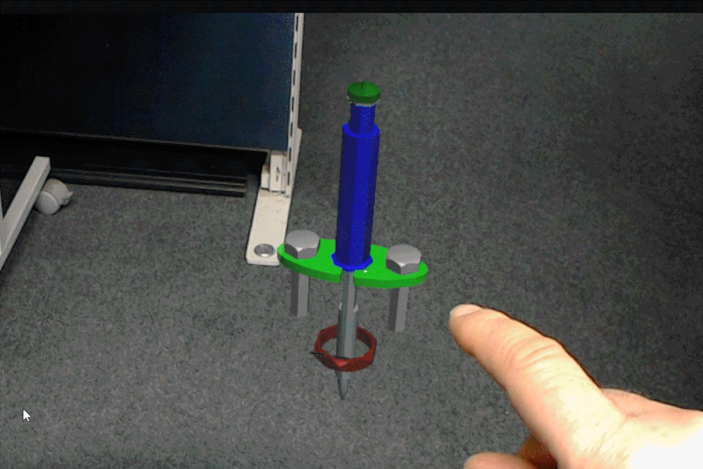

Will work on both in preview and on HoloLens:
here on the HoloLense:2019-03-11_18-02-41.gif
So here the opacity -> tha alpha channel /  is defined but the color should not be changed:
