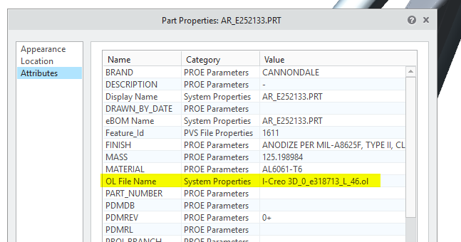

I have an assembly i'm running thru the CAD optimizer on import and the appearance of the HIGH output are great but it is eliminating one of parts, technically the .ol part is still there in the .pvz but it has not surfaces in it. It's a sizable part volume wise relative to the assembly (assembly is a bicycle, the missing part is the handle bar). The part goes "missing" form all three of optimized outputs.
Does anyone have suggestions on .rcp file modifications that might fix this? or a location for good documentation on said files?
I have a poor work around that involves replacing the "missing" part in the .pvz file with the unoptimized version from the inital .pvz file. This works but is manual labor every time I update the 3D and also bloats the file as this one part unoptimized is way higher detail ans size than it needs to be.

No this is still a problem and just happened to me on a project on Monday. I was never able to get any better results from changing the recipe files. The strange thing is that the "missing parts" seem to usually be on the High version of the optimization. And the Med and Low version will have the parts in a more complete version. With more experience what I have found is that the parts are not truly missing but they are just poorly optimized.
I have seen the following "optimizations":
  • All surfaces of a parts removed
  • All surfaces removed from a mixed solid/surface model
  • All the geometry collapsed down to a tiny sphere
In all of these cases these problems were on the High model. The only solution I have found is to unzip the High model find the .ol file for the bad part and replace it with the .ol file from the Med optimization.
For anyone else looking at this thread with this problem. The easiest way i have found to identify this bad .ol file is to open up your optimized pvz in Illustrate, select the part and then "Edit Properties". Under the attributes section there is a line for "OL File name" this will give you the file name for the .ol file in questions. These file names are consistent across all optimized versions and the original pvz.
