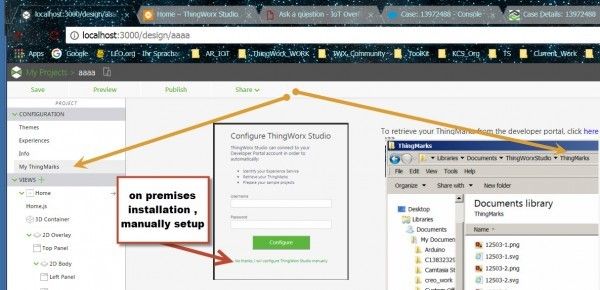

Probably my question is not still clear. So I have attached an image to explain what I am looking for. Thanks.
- Ravi
dupatel
(To:rsingaram)
@rsingaram Thanks for sharing image and as advised at the moment we cannot add or upload any external ThingMark into Studio application.
So, you will have to enter the ThingMark ID manually to use it. e.g let's say you want to use ThingMark file with name 1872-1.svg. Then manually enter the value inside the ThingMark box as 1872:1 so that it looks like this -
Similarly, for other you can use values as 1872:2, 1872:3...and so on.
I believe you missed the catch with default text which says - "Enter or Select" .
Also, make sure while using the ThingMark widget inside your View , ThingMark ID is updated similarly based on the ThingMark been used in your project.
-Durgesh

How to set the thingmarks in a ThingWorxStudio project without logging in the development portal?
  • If you  want to set the thingmarks in the Project - Menu : My Project > currentProjectName > Configuration > My ThingMarks. And you want to  set  it generally for all new VuforiaStudio projects.Copy the new thingmarks to .Documents\VuforiaStudio\ThingMarks folder bild1.jpg
  • Modyfy the ...Documents\VuforaStudio\builder-settings.json (but first do backup copy of this file!!!)  file by adding some thing like (relevant new part in orange color):

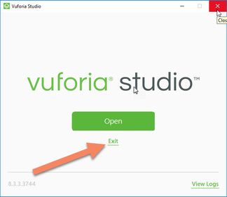

  • Important when you save this file you need to restart Studio. But if the Studio process is still active it will override this setting and you will see the old setting. In order for it to not overwrite any changes you make in that file, kill Studio first then make the necessary changes. On Windows, in the system try there should be an icon for Studio, right click on it and exit to fully kill Studio.
  • Now when you restart studio you will see your new thingmarks in “MyThingmarks"
