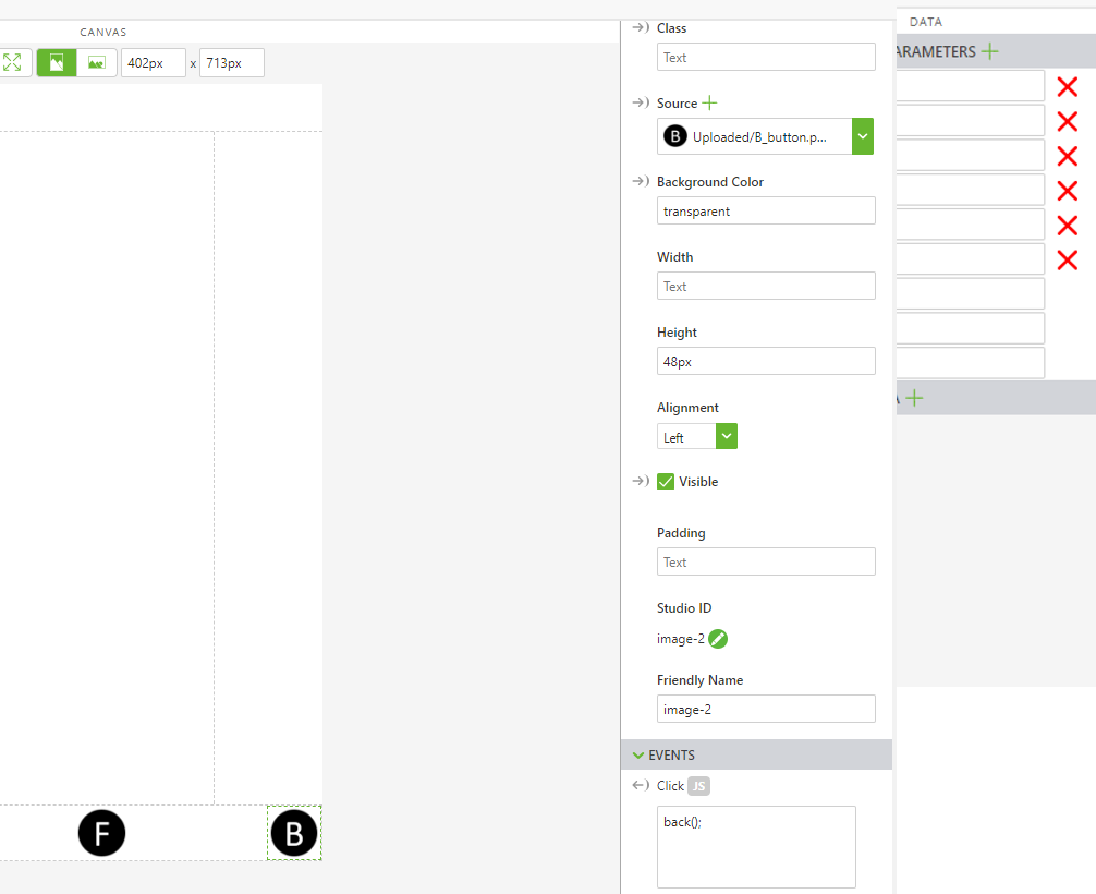

The easiest way I can think of would be to move the model around underneath you.
  1. Create application parameters for the position and rotation of the plant model and bind them to the model values.
  2. Create some javascript functions to change the values of the plant position so that it moves underneath you.
    $scope.front = function () {
    $scope.app.params['model_x'] = 0;
    $scope.app.params['model_y'] = 0;
    $scope.app.params['model_z'] = 0;
    $scope.back = function () {
    $scope.app.params['model_x'] = 7.43;
    $scope.app.params['model_y'] = -0.917;
    $scope.app.params['model_z'] = 19.87;
  3. Create some buttons that can be clicked on to run the java function and the model will jump underneath you to the new position.
Hope this helps.
