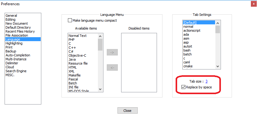

You could use Notepad++  as your editor. In Notepad++ under "Settings"--> "Preferences..." you can change the "Tab size" and check "Replace by space" in the "Language" settings.
