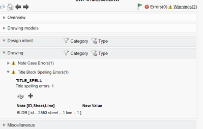

How are you getting just the misspelled words? I see the *.d.dsumm.html and .xml files. Have you created report just to show the spelling errors?
Open the *.d.html files.
