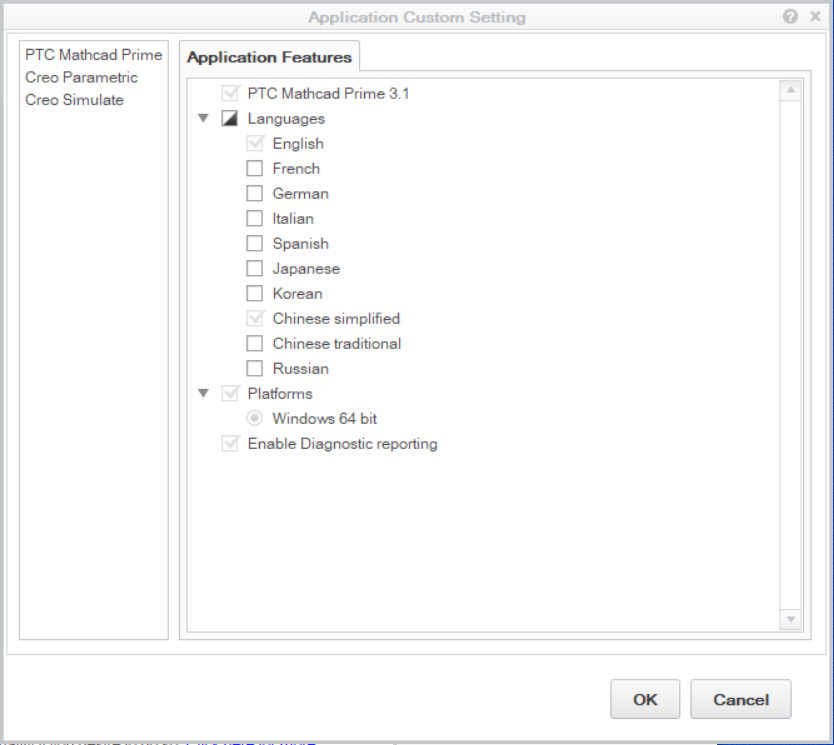

Thank you Tom. I did find this article yesterday and verified there is a Chinese_translation in my license (global) . and now I can write Chinese in drawing. the problem now is when opening drawings made before (with separate Chinese module), all Chinese show as boxes. I guess some Chinese fonts are missing. Then I tried to copy all fonts to PTC font folder per article CS35525 but it still doesn't work.

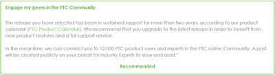

Looks no support is available for my version (Creo 3.0 M190)
