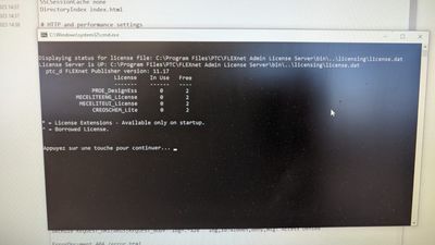

We recently changed the network in our organisation. The server holding licences for creo didn't change, it just change network.
Although the server is up and we can ping it, people can't access their licenses. Here is the creo error message and the result of ptcstatus.bat on the user side.
And here is the result of ptcstatus.bat on the server side :

Turns out it was because my network was classified as public and not private so the exception rules for port 7788 didn't apply. The troubleshooting tool solved it.

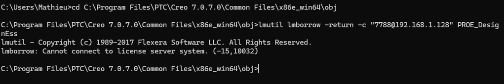

We managed to borrow licences running parametric_borrow.bat but we can't return them when running inside repertory "C:\Program Files\PTC\Creo 7.0.7.0\Common Files\x86e_win64\obj"
lmutil lmborrow -return -c "7788@192.168.1.128" PROE_DesignEss
 the error returned is :
We will work with those borrowed license until our deadline and try reinstalling License management application on the server.
