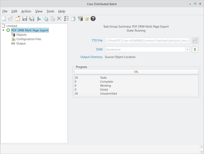

I am trying to batch convert drw to pdf. I have set the pro_lang=English as suggested by some threads. I have created a config.pro with search paths pointing to the parts of which drawings are to be converted to pdf. However, when I run distributed batch it does not runs, instead it gets stucked at "Unsubmitted" stage. The status colors are all yellow. Even if I stop the process it does not stops, rather I have to force close. I have reconfigured the creo to use creo distributed batch. Tried even from ptcdbatch.bat file. But of no use. Please help me as I need to batch convert more than 300 drawings and would take ages to do that.

I started ptcdbatch.bat and defined PDF export batch and start it

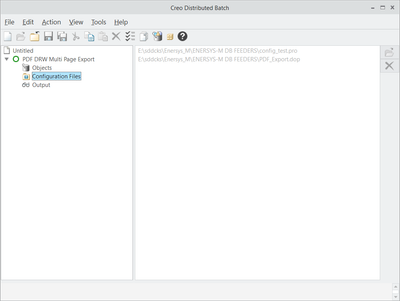

@MartinHanak , I followed the process as mentioned by you in the above steps, but still the issue persists.
Check the configuration files:

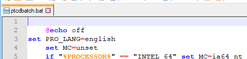

Also, I have edited the batch file for ptcdbatch.bat as suggested by you (adding indentations accordingly).
Is there any way how can I check the backend process, where exactly it is getting stuck, so that I can post the issue to this thread.

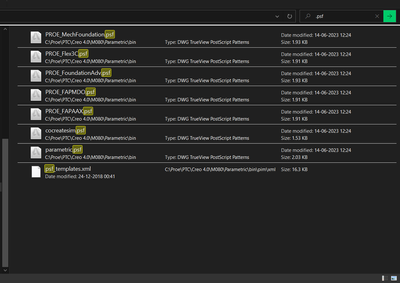

Please provide the list of .psf files located in Parametric\bin subdirectory.
Martin Hanák
Dear @MartinHanak ,
Please find list of .psf files.
@KS_10705911 wrote:
Dear @MartinHanak ,
according to the picture, six Creo startup psf files exist in you installation:
PROE_MechFoundation.psf
PROE_Flex3C.psf
PROE_FoundationAdv.psf
PROE_FAPMDO.psf
PROE_FAPAAX.psf
parametric.psf

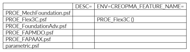

Each of these files contain following lines
DESC= ... this line contains description text
ENV=CREOPMA_FEATURE_NAME= ... this line contains license specification

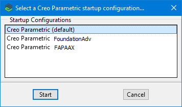

On Desktop create shortcut of C:\Proe\PTC\Creo 4.0\M080\Parametric\bin\parametric.exe
Doubleclick the shortcut and send me picture of startup window similar to the following one
Inside this window you can see DESC values,
Please publish ENV=CREOPMA_FEATURE_NAME values for the above mentioned six psf files. (this information is not secrete I think).
Compare your ptcdbatch.bat with my ... see below

ENV=CREOPMA_FEATURE_NAME=PROE_FAPAAX PROE_FAPMDO PROE_FAPMDOG PROE_Flex3C PROE_FlexAdvMDO PROE_FoundationAdv PROE_FoundationAdvG PROE_MechFoundation ()
This is the value
The value of ptcdbatch.bat is exactly same as yours.
1.] OK. The contents of ptcdbatch.bat is correct.
2.] I expected table similar to the following one
3.] Please send me picture of startup window.
Martin Hanák
Please find below snap
