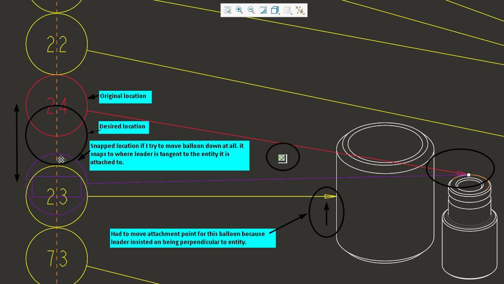

Is there any way to disable, or at minimum override, the sketcher type constraints that effect the placement of balloons?
I am placing roughly 100 bom balloons on a drawing view and am having issues with positioning the balloons were I want, because they insist on snapping normal or tangent, or so on, to features and components.
Is there any way to disable this? In sketcher you could temporarily disable or ignore a constraint if you needed, by right clicking or selecting the constraint and deleting it. That does not work for the constraints that pop up while placing a balloon. I believe all notes behave this way, but placing balloons is where it is causing the most issues as generally things get pretty crowded. The range of the snapping, precision if you will, is very large too, 10 degrees in my case.

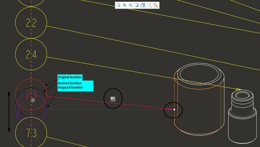

I attached two snapshots.
If I try to move a balloon and it happens to be near a point where the leader line is near tangent to the attached entity, or perpendicular (normal) to it, it snaps to where it would be tangent or perpendicular to it.
There is no way to disable this that I am aware of. I would think you could right click to disable the automatic snapping constraint, like you can when you are in sketcher mode creating a feature, but this does not work. Just the same, disabling the constraints activated for sketcher does not effect this behavior.

It is not related to the snap lines. It will snap to the constraints relative to the entity it is attached to regardless if there is a snap line for lining the baloons up or not.
If I did not mention it earlier, you cannot select the constraint or even hover over it and have it pop up the text like in sketcher where it says, "constraint, normal, strong" or similar.
