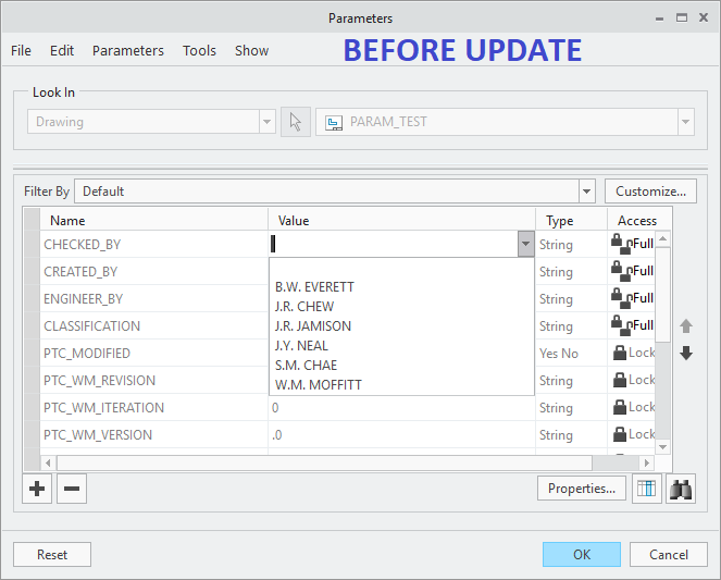

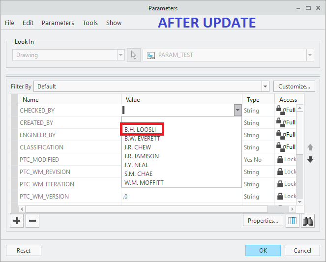

When I changed a value in the restricted_params.txt file and then launched Creo 4 M060, The file is loaded.
I then created a new drawing which has local parameters defined, verified that the addition was NOT in the drop down box for my parameter and went to Tools-Update Restricted Parameters and got the message that the file was up to date with the external file, which I know it is not.

I have created a Word document showing the text and screen shots.
TomU
(To:BenLoosli)
It's working flawlessly for me.  Are you 100% sure the file you're editing is actually the file being loaded?

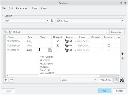

Did some more investigating and it looks like the problem is only with drawing files!!!
I loaded my start part and start assembly and they showed that the external file did not match. Selected Update and they updated the list the way it has always worked.
Went to add the Checked_by parameter to the start part and it found the list from the external file, like it always has.

The test I did was to a drawing...
