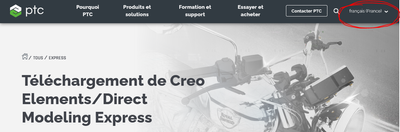

Try another language for the web page. French for example. Anyway Modeling Express will be in English.
http://kotom.eng.free.fr

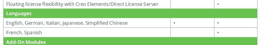

Still as a supplement.
Excerpt from this article
https://www.ptc.com/-/media/Files/PDFs/CAD/Creo/37318-CED-Topic-Sheet-assets-1.pdf
page 3 of 5
Unfortunately it seems that French and Spanish are again only available in the paid version.
This was already the case in version 6.

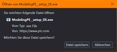

The download link is the same for every language setting of the download page.
https://www.ptc.com/-/media/Files/creo/elements-direct/64-bit/ModelingPE__setup_EN.exe
If you now change for example the link for German   from EN to DE
https://www.ptc.com/-/media/Files/creo/elements-direct/64-bit/ModelingPE__setup_DE.exe
Then you can download this version.
Changing to 'FR' unfortunately does not work.
Since I am German-speaking, I have first installed the English version and then the German version.
The result is that I can start both languages.
