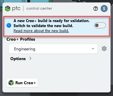

I tried mine and I was able to load creo fine.
I don't know how to re-load the software but maybe you can switch to the validation verison?

I cannot get to the control center.
It give that same error when I try to load the control center.

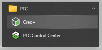

In my start window, if I click on either I get the same message:
In the tool bar I don't have the Creo+ in the pop-up.
