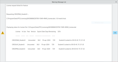

Once i opened Creo Parametric 5.0.6.0. it showed the error below
please help

please explain in detail how did you get the license.
Also open Command prompt windows, run ipconfig /all > ip.txt command and upload ip.txt file.

It's working now. Thank you
I try installing using personal Wi-Fi or hotspot from mobile. I faced the same issue when I installed the licensing using public Wi-Fi. Creo licensing is quite weird because it’ll setup the license environment based on the user Wi-Fi. Maybe it is student version.
I did as follow:
1. Reinstall
2. Delete all data
3. Again download by using personal internet
4. Again install.
