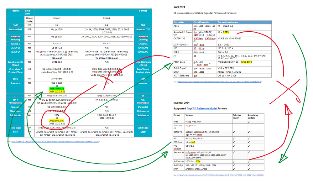

I am using Creo Parametric Release 10.0 and Datecode10.0.2.0
Creo 10.0.2.0 Supports the import/unite of SolidWorks 2023 data.
When do you plan to support SolidWorks 2024?
This is a major Roadblock for our Creo 10 update with important new functions.
CS134024 only shows SolidWorks2023 from Creo 10.0.2.0

You might see 10.0.5.0 support SolidWorks 2024 when it is released in June.
Creo 11.0.0.0 was released after 10.0.4.0 and it only supports SolidWorks 2023, too.
It does take time for PYC to verify that any changes in SW are compatible with Creo and don't cause issues.
The delay between version releases is something that all companies go through when they use multiple vendors for their solutions.

If you can login, here is a link to the Creo 11 product matrix.
Nothing is mention about Unite.
https://release-advisor.ptc.com/releaseMatrix?releaseId=1918

There is a plan to support SW2024 in Creo Parametric10.0.5.0.
As validation is still in progress, support for Creo Parametric10.0.5.0 or Creo Parametric10.0.6.0 can be confirmed by end of May.
