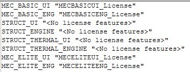

Compare the contents of this file on both machines:  Common Files\applications\simulate\text\licensing\mech\feature.dat
Mine looks like this:

You might be right. The file on the working machine looks just like yours.
The file on the offending machine looks like this:
MEC_BASIC_UI "<No license features>"
MEC_BASIC_ENG "<No license features>"
STRUCT_UI "<No license features>"
STRUCT_ENGINE "<No license features>"
STRUCT_THERMAL_UI "<No license features>"
STRUCT_THERMAL_ENGINE "<No license features>"
MEC_ELITE_UI "MECELITEUI_License"
MEC_ELITE_ENG "MECELITEENG_License"
I updated the file and am testing.
That was it.  Many thanks.  Couldn't have done it without your help.
