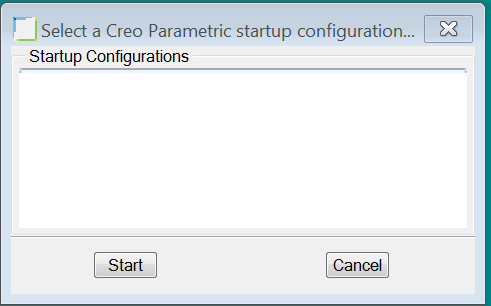

When I reserve a floating license, the window with the list of available
licenses appears.
Instead of setting a custom name manually in each client, I would like
it to be displayed directly from the license name set in the server.
Did I explain myself better?
if you launch Creo, following window appears containing a list of start configurations.
Descriptive names are extracted from files with psf extension which are located in Parametric\bin directory.
Martin Hanák

BenLoosli
(To:IT_heidolph)
If you create multiple PSF files, you should get the option to choose which one you execute.
You may NOT edit anything in a license file except the server lines at the top of the file.
You can also create a custom BAT file that calls a specific PSF file. I do this for the 3 licenses that I manage. The users are given the batch file shortcut that I choose for them. They have no idea of the other configurations that we have.
